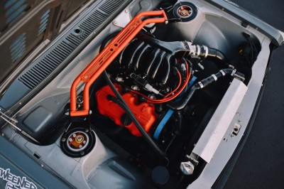

Hello fellow Datsun owners..I have a question and looking for some.insite and history on 510 that was purchased from AZ in mid 2018 ..the previous owner I would belive was a active member of desert datsuns.com Ryan Newman..I purchased both his cars ..but more so looking for history and build sheet specs on the VG34 wide body 510..I know there was a write up on the build .but assuming since the site was taken down all that info was lost..if any of u guys could help that would be teriffi9

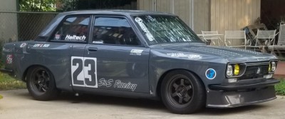

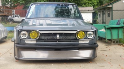

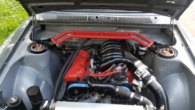

As some of u may have known Ryan..here is the current state of the car..
