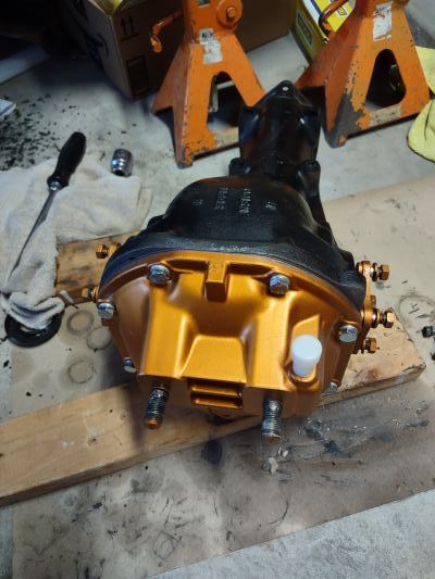

This thing left me battered, but not beaten.
While taking the greasy differential out about 7 weeks ago, it tumbled off the jack and onto my right hand. Fortunately it only crushed the tip of my thumb.
Even with my thumb in a splint I managed to clean, paint, and reseal the unit, and added an M-factory helical limited slip unit and new carrier bearings "While I was there."
