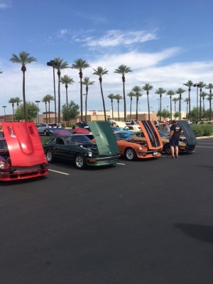

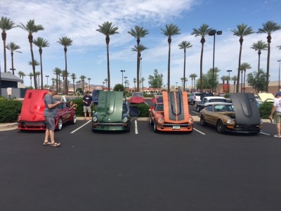

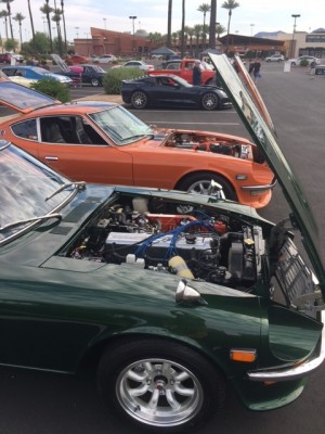

Had a nice morning at the Pavilions show yesterday.
