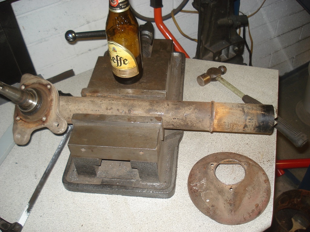

Decided to work on my front struts......
Blew off all the dust, removed the springs and the old shock insert. Cut off the upper spring perch by scoring it all the way around with a hack saw, then striking it with ball peen to tear the perch off where it was scored. Ready to cut and shorten the strut tubes for the new inserts now.
I rated this step at a 1 beer difficulty level.
Deeply score the perch slightly above the weld
The original weld remains after the perch is removed
After scoring the metal, tap the perch to tear it away
Spring perches have been removed

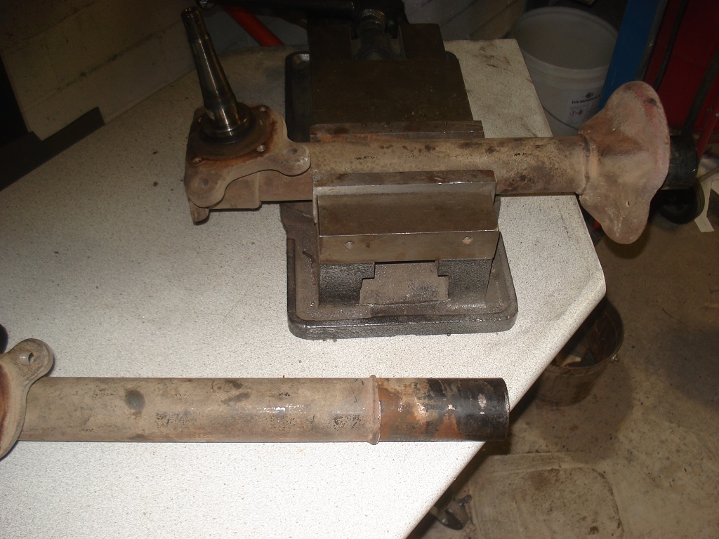

Cut the front strut tubes and shortened by 3 3/8" to accommodate Koni Race shock inserts (these are 280zx struts). Struts were then welded and ground down enough to allow the coil over sleeves to slide over them.
First cut on the strut tube
Strut sections welded and ground down
Small gap here to allow tightening the shock retainer nut
Test fit before welding on the sleeve retainer ring
