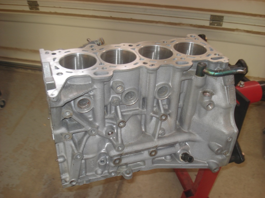

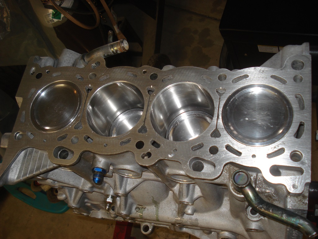

- Got my engine block back from the machine shop last week. Had it bored and honed for some 87 mm pistons. Will start assembling it as soon as a couple more partts come in.
Engine bored and honed

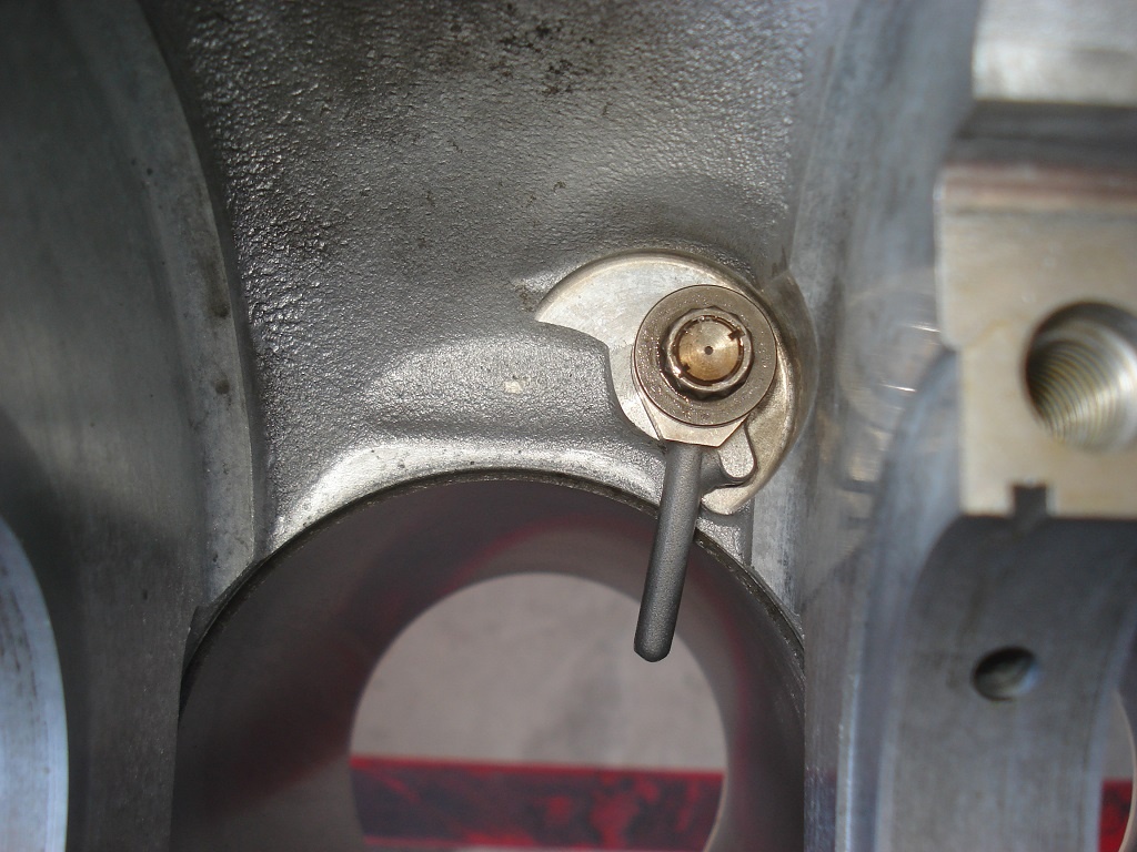

- Finally got parts in. Been waiting for a piston cooling jet. One of the original ones had a stress crack and broke when I was getting ready to start on the bottom end. Parts came in yesterday, and I got the jets installed. Main bearings and crank next....
Broken jet.  New one on the left.
Oil jet installed.
Oil jet installed.

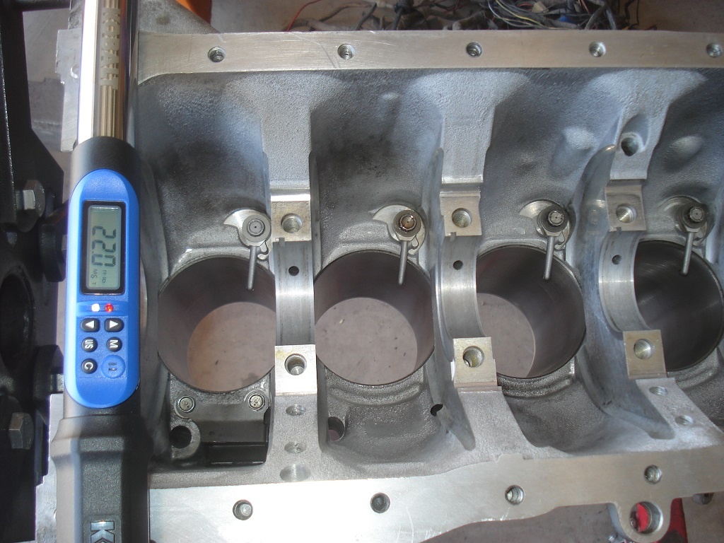

Torque to 17 ft lbs first pass, then 22.

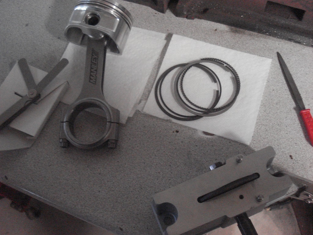

- Started gapping rings on Saturday, but got interested in fitting the intercooler/radiator so still have a couple sets of rings to finish.
The rings came as "file to fit" for the normally aspirated engine, so fitting them to the turbo engine takes quite a bit of grinding to get the gap correct. I just have one of those old school hand grinders, so it takes about 30 minutes per ring set. One of those jobs that you just need to take your time on though.
Checking ring gap
Checking ring gap
Old school grinder
Old school grinder

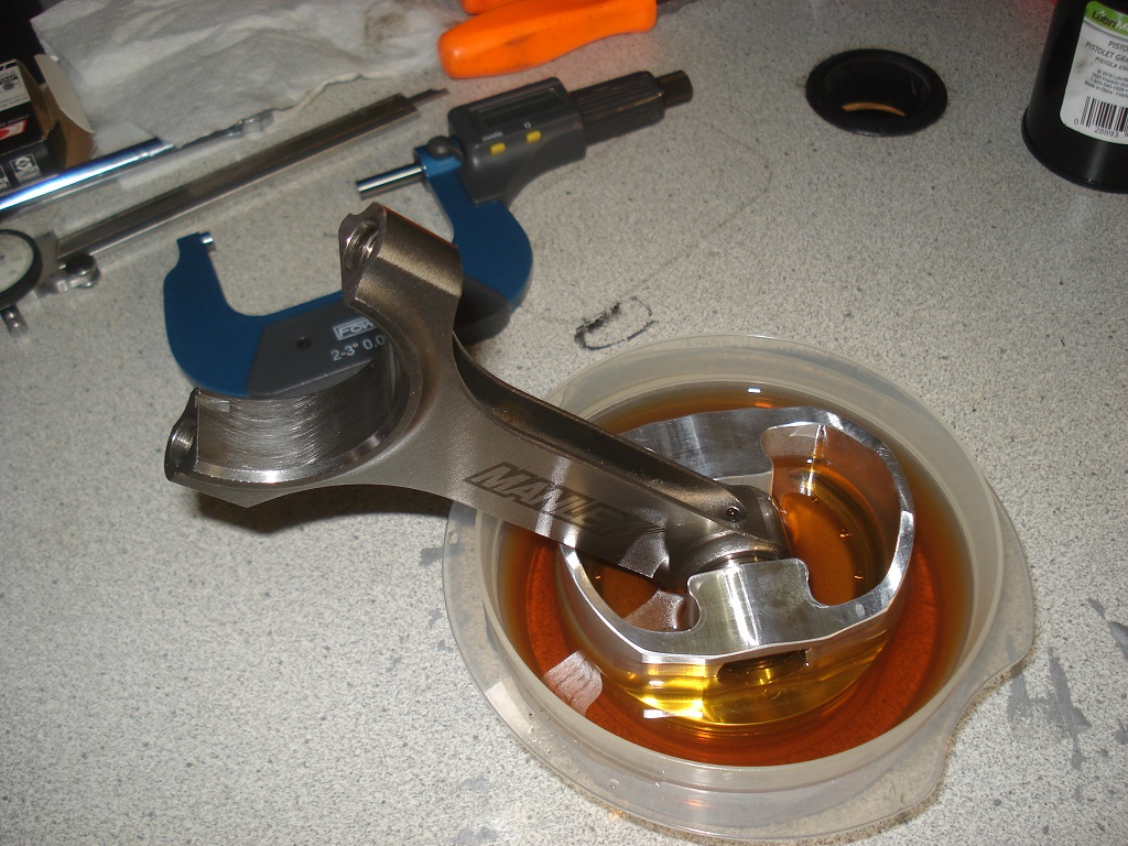

- Back at the bottom end rebuild. I guess I put this off an ample amount of time. I really don't enjoy working with an oily slick ring compressor. If I ever do another engine, I am going to get one of those pliar type compressors instead of the old wind up style. That said, I have all the pistons back in their appropriate holes, torqued and ready to move on.
I put the pistons in "wet", because that is how I have always done it. Messy and smokes a bit when you do that first start up, but it has always worked okay for me in the past. Timing chain, tensioners and front cover / oil pump coming up next.

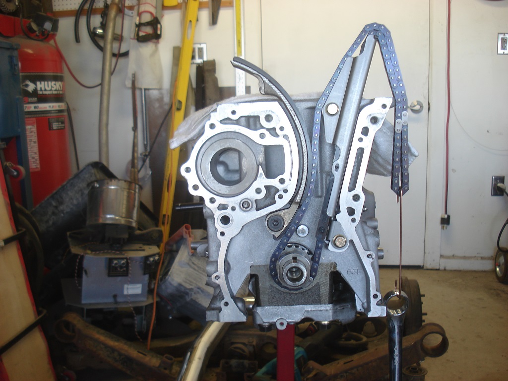

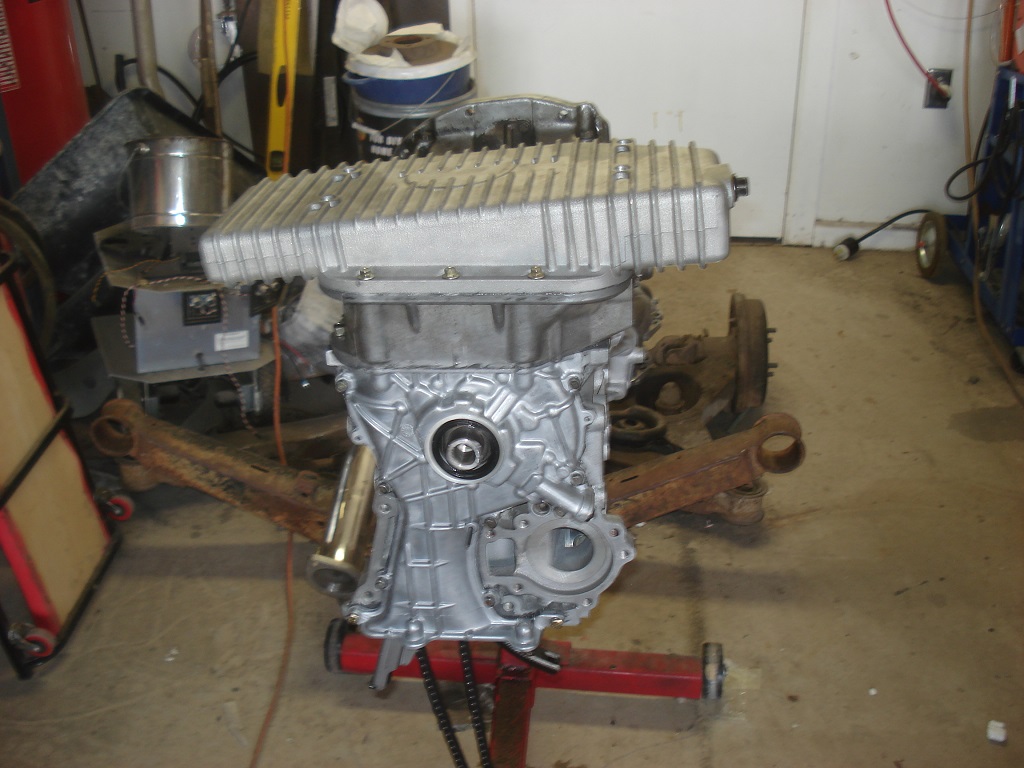

April 18, 2021 Done with the bottom end...
So, finished up the bottom end. Went pretty smoothly, Standard missing parts.... found them, nasty stuff cleaned up, etc. Need to get the head ready to install next.
-Guy
New timing chain and guides
Fresh oil seal for rear
New front cover/oil pump
Oil pan installed
Oil pan installed

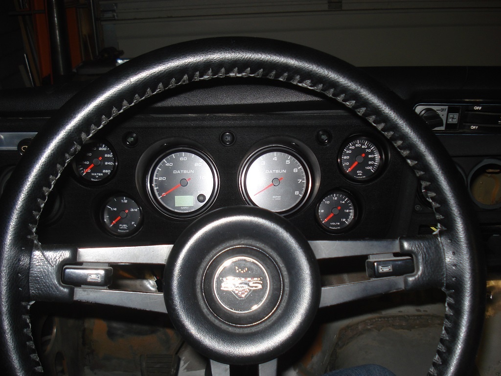

Got my Gilson dash in....
Post by insitu_az »
My Gilson SSS dash finally arrived a couple weeeks ago. I was a bit discouraged when it arrived, because for some reason I was expecting it to just bolt in place.....
I did a thread on the 510 Realm on how I managed to overcome the fitment issues, but overall it is a pretty nice piece. After fitting the panels, I carefully disassembled and stored it away. :D
Nice job, looks fantastic. :)
Posts: 946
Really, really nice work Guy. Can't wait to see this one on the road!

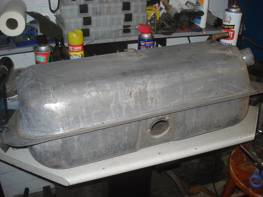

So, I am waiting on a couple items to finish my engine and decided to tackle the fuel tank.
I had a tank "tanked" a couple years ago to get the muck and old paint off it. Today I removed the old fuel line connectors and vent tube from the tank and cut a 4 1/2" hole in the top to hold my fuel pump. I drilled all the holes to hold the seal and pump mount, then grabbed the shop vac to get most of the metal filings out.
After a few minutes with the shop vac I peered inside to be sure I had gotten most of the shavings out, and to my surprise behind the baffle on the far side of the tank, there was a pistachio shell sitting in there. Just one of those things that make you go Hmmmm...
Naked fuel tank...
Naked fuel tank...
I will post some more pictures when I have finished this project.
- Guy
Posts: 946
Guy, I may have told you I had a similar Hmmmm... moment when I got my 510 home after driving it back from across the country. While vacuuming under the driver's seat I heard a "flump" sound that sounded strange. When I opened up my shop vac I found a baggie full of hash, Hmmmm...
