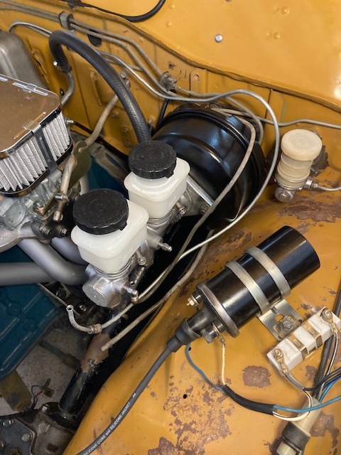

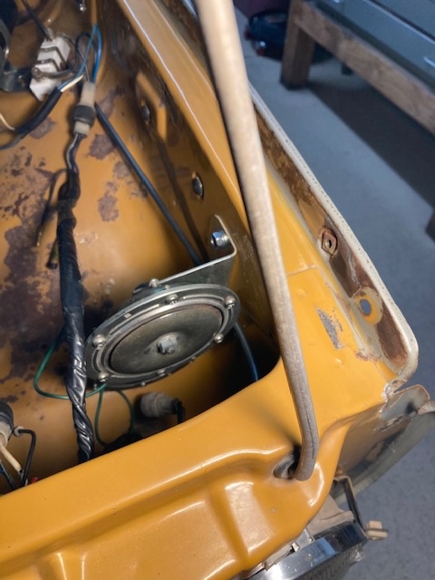

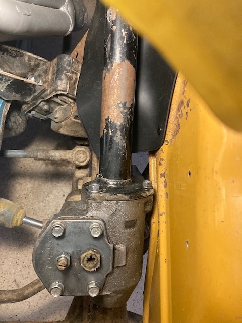

installed the brake booster I repainted and the freshly cleaned brake and clutch master cylinders. Also installed the rubber flap I copied from the trashed original one, to cover the upper control arm on the driver's side. Also cleaned up the steering box. Seeing the rust on the steering column in these pictures, I'm adding masking and re-painting it to my Friday to do list.

Maybe hit up one of the paint matching places, get a rattle can and a pint can. Thinned down, if you brush it over those bare / rusty spots, it'll blend nicely, be less obvious, and look like a nice matching patina (just a thought).
Looking great amigo!

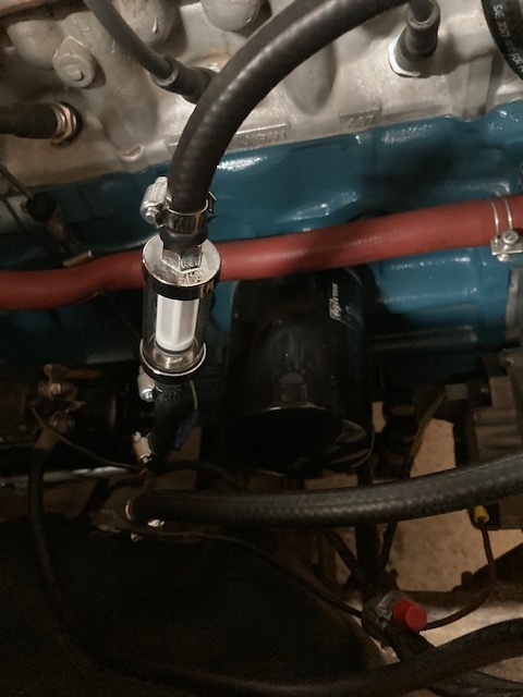

Great idea, tinting some thinned down paint to make the surface rust less noticeable. Thanks! I pulled the radiator today to install the fan shroud, but unfortunately the shroud is too small to use. I'm not going to worry about installing one for the time being since the larger fan will likely move more air. This afternoon I finished detailing and re-installing the two horns, and added a Mr. Gasket glass fuel filter so I can monitor fuel coming out of the tank once I drain what's left. Getting very close to turning the key and, hopefully, hear it come back to life.
