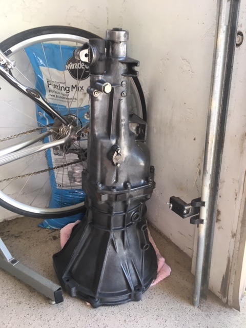

Just finished cleaning up the new close ratio 5-speed for my orange Z. Birdman had an excellent recommendation for cleaning up greasy parts (trans, diff, etc.) quick and cheap. The 99 cent store has oven cleaner for 99 cents a can, which is about 1/4 the price of brake cleaner. I sprayed in on the transmission and set it in the sun to work. I then rinsed everything off using a wire bristle brush to further loosen up the sludge. Of course you need to block off all the openings where you don't want water. I used a dental pick to get into the tight areas. Once done I sprayed the case down with WD-40 and wiped it dry. Very happy with the results.
Re: Speedo Driver
Wow, looks great Randy. Looks like that oven cleaner did the job!
Re: Speedo Driver
Thanks Dale. Just ordered up new input and output shaft seals, clutch release bearing and slave cylinder and hose. Want to be ready to install it when the weather cooperates.
